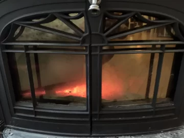

I think cat temp was at about 132 when I closed the bypass. Took a while to get there stove top was at about 550. I did get a quick rise to about 800 then slowed down quite a bit so I opened the bypass again for a little while to try again. I think after that it got to around 1100 and stayed there until I started turning down the air. From there it dropped back to 800. I am attributing this to having wood that’s around 25%. Hoping that there is not something wrong with the CAT. At least I am now able to monitor the temps in second burn chamber.
Gentlemen,
Currently GT at 550, probe around 1150 (slowly climbing) and some nice dancing flames in fire box.
After playing around with when to close bypass and when to start shutting down air I think I have found the sweet spots of this stove. Happy to see my CAT seems to be working properly. This CAT probe was a MUST. No telling how many times in the past I was closing bypass to early or not shutting down air properly. Probably took a couple years off the cat but at least I know now!
Can’t thank you guys enough!
