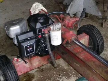

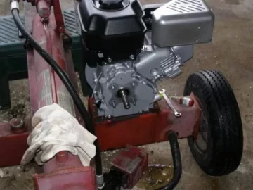

Put a new motor on my wood cutting buddies spliter this afternoon it sure beats the old briggs pull it 20 times before it would start motor that he had mounted on it LOL Picked up a horse with the new motor also, we split a truck load after install sure worked alot better!

Sweet!
Good for another 10 years a least.
Does that read 6, 8 or 9 HP?
Looks great mounted on there. New splitter!
Its some new marking briggs has decide to use its a 205 cc 9.0 ft lbs. it comes out to 6 hp don't understand why they just don't put 6 hp on it. lol Think they like all the other crap stuck on there as a smoke screen. He had a 5 hp on there it was just getting worn out I kept the motor for future project it really just needs some TLC. Yes it worked out well about an hour change with new lovejoys installed as well.
Yeh, give the cubic centimeters of the piston, foot lbs of torque, I guess HP varies by the carb, exhaust & other mods.
Saves them testing. Some rated HPs, not necessarily usable HP. Like you, I think it is meant to confuse & look good.
It splits wood very good, that's what counts. (But does look good on there too.)
