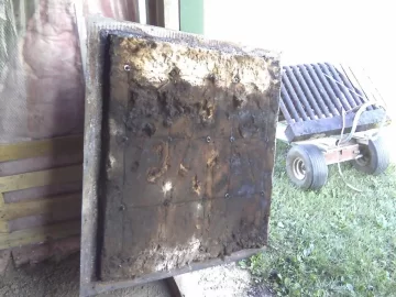

I just used 3" bolts with fender washers ....welded the nuts to the skin.....laid the insulation on and ran the bolts thru
  • Top of Greenwood extremely hot
Thanks for the help and the pics guys. Will pull the GW apart tomorrow to get a better look. Ordered some 2" Kaowool from ebay for a pretty good price hopefully it shows up soon.
Well I pulled the top off the the GW this afternoon the insulation looked fine. Now I'm a little baffled I think maybe the creosote on the insulation or between it and the top skin possibly caught fire and caused the top to get so hot??? Whatever.... I'm firing it back up now.
