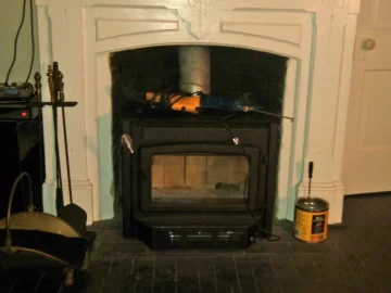

I fabricated a two piece block off plate by the damper then used high temp silicone to seal it. Now I have a stupid question. For those that clean their flues multiple times a year, do you guys rip off the block off plate each time? If I did that, I'll have to keep buying the high temp silicone and resealing.
Next year I'm going to rip out the damper frame and fabricate a one piece block off plate. In the mean time, assuming I find the courage and a tall enough ladder to clean the flue myself, how will I be able to get to the deposits that will presumably land on the smoke shelf? Even if I made a clean out point, I feel like I would still need to stick a vacuum attachment up there.

Nope I don't. That's coming next year too. Starting to feel like I'm not really prepared to burn wood this year.
Eeek.. DO NOT BURN without a liner. Period. I was about to comment and ask about your liner as it sounds like you have draft issues. The block off plate is for your liner to come through the damper area and block out the fireplace.

I have something like that, just not nearly as pretty. I just don't have the liner. You don't seal around the block of plate's sides?
Glass built up residue so I guess I'm under-firing. I can't seem to close the primary air all the way down without the fire smoldering

Block off plate is of no use without the liner, you are actually hurting your draft even more.
Wouldn't the block off plate help force the flue to draw from the insert? If not, I'm totally confused about how this wood burning thing works. Thought I had a good general idea before today.
So you slid the insert into the fireplace with nothing connecting to the exhaust on it and made a block off plate with im guessing a 6" hole in the middle of your damper?
No, that would be kind of stupid I think. I have a pic on page 1. You can see the outlet pipe going up and into the block off plate. Sorry, kind of a bad pic. Took it last night.
Also, the insert isn't fully in the firebox. The back of it is probably 6" or so from the bricks.
Only pic I see on page 1 is of the insert. So you have a positive connection, 6" stainless steel flex pipe through the block off plate to the first tile of the chimney?
Jeez, you got me all nervous now lol. You can't see the pipe from the back of the insert going into the block off plate?
It's not flex pipe. Not sure what you call it but it's pipe with an adjustable angle thingy. Sorry, I'm probably screwing up every single wood burning term there is.
Is your stove stubbed with a pipe from the stove to just above the damper? If so, that is legal but often a poor setup for draft and lousy for cleaning because the insert needs to be pulled each time to clean.
I lightened up your picture. It looks like you are using regular galvanized duct pipe. That is not permitted for fireplace installations and should be replaced.
[Hearth.com] To All the Hearth Nerds....
Yes it is. That's what I was wondering about. Father in-law installed it. I can actually get to the damper area and everything with the insert in place.
