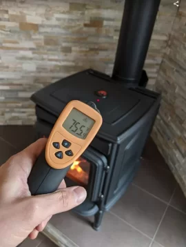

I found my IR gun yesterday. The stove top thermometer is reading about 150-200 degrees low as I suspected. Stove top temps were likely in the 700-750 F range. Too close for comfort!
The IR will provide better guidance until you get a good thermometer. Read the flue temp 24" above the stove too. As noted, that is more meaningful.

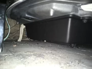

Oslo, with rear heat shield, and main air intake highlighted. A quick look up of previous threads on the castine mentioned a similar setup and location

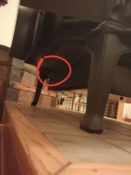

I don’t have heat shields on my F400 but the primary air intake is rear center behind the ash pan. You can see hole ( top right quadrant of the photo).
