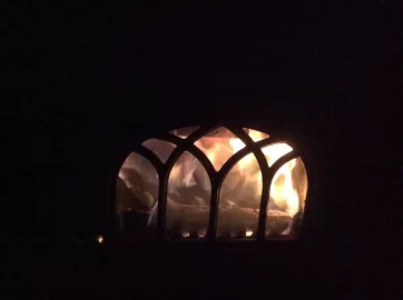

I just saw this thread. My stove burns perfectly and does have all 4 bolts in place. I will check the gasket when the fire dies down. In this photo it looks a little stronger on the right but it's just a trick of the light. My little stove has been perfect for the additional heat I need!
