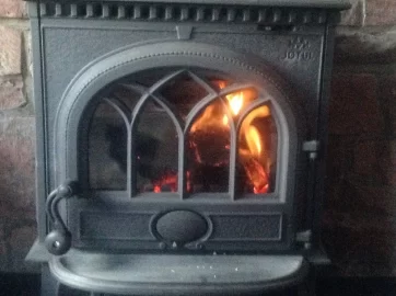

So I had a look at the stove top for any sign of it being seated unevenly. Not much to see... Maybe it was a little higher in the front, but it was so negligible I wondered if it was just my imagination. The stove top was actually touching the top of rear heat sheild... I noticed that wasn't the case in your pic from a few years ago, but the design looked a little different, so it might just have been that.
Anyway, I took off the stove top, gave it a wee clean (there was nothing untoward to see inside.. no soot trail) I turned it 180 degrees and re-seated it. That was definitely the issue. It's burning fine now. Thanks so much for the help, Begreen.
I do think the stove is still ever so slightly favouring the secondary burn on the right side, but honestly it's such a tiny difference, I wouldn't even be noticing it in another context. I think I'm fine with it.

Fiona I do not have a dark side, it seems to depend on where I place the wood that I will see burning occurring. If I use small pieces and place more to the left, it burns on the left, I guess that seems obvious but I use 18-20 inch logs in my castine so it seems to burn evenly across the stove. Hope your jotul rep can help you.
The F3CB should burn pretty evenly too. The only time it didn't for us was when the top wasn't on right.
I'm placing a lot of hope on the issue being around the four missing bolts. The burn plate and the side baffles change position pretty easily; getting touched (not hit hard) with a log as it gets wiggled into place can be enough. Yesterday morning, when the stove was cold, I had to move the right baffle and the burn plate back into their correct position, burn plate was siting too high on one side, creating a visible space between the top of the side baffle, which was leaning in slightly, and the bottom of the plate.. That kind of thing has just got to make a difference to performance, hasn't it?
What's wierd though is that very, very occasionally it burns evenly. I just can't see what is happening when it does. Might just be that the baffles and plates (and the stars too!?) have been knocked into alignment for a while...
