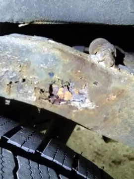

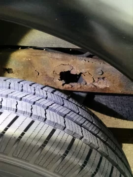

Lakeside, my day finally arrived. For a few months the ride just seemed slightly "off". Just doing a routine walk around, I saw the holes in my frame!! Above the rear wheels on both sides. Crikey!! It's Thursday. My main mechanic was completely covered up. Shot off to another mechanic at a dealership who looked at it. He suggested welding.
Had to go play a gig out of town Friday. Man, if I saw a speed bump it was "recalculating route"...

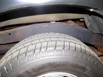

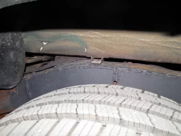

Well, another friend was able to do some welding on Monday. We cut plates out of steel and got them welded to healthy metal. The repair will be stronger than the frame ever was, so I've got a year or two to do a frame replacement.
As I understand it, the frame replacement should be less than $10k. Say I get it done in 2020. It will probably last for 15 years??? I'll be the 77 year old "original owner" of a 2002 Tacoma that's 33 years old. Excluding maintenance, my $23k purchase price plus $10k frame replacement will average out to $1k a year.
The joke factor alone is totally worth the cost!
The holes were more severe than depicted in the photos after I pressure washed all the rotten crap out of there.

Here are the after photos.

Thats a death trap. ID be finding another ride while you figure out the best way to suicide it.
That's a death trap. I'd be finding another ride while you figure out the best way to suicide it.
I appreciate your concern and we're here to help each other, so thank you for your perspective. I am taking it to heart in the way you intended. None of us would sit idly by if we saw something dangerous.
At the moment, I've got two certified Toyota mechanics and a guy who spends a lot of time at 125-150 MPH who think I'm OK for today. They got the "eyes-on" perspective and at least 100 years of combined experience.
My intention was to not exceed 12 months with the current solution. Based on your caution, I'll try to speed up the frame replacement.
Thank you for your honesty in this PC world.
