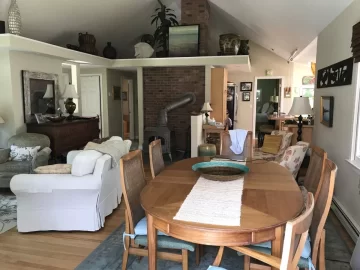

This is the space I heat...kitchen over to right..bedrooms in back..
15’ peak ceilings...beautiful but problematic...and loft over woodstove is where the heat goes..I have fan up there..

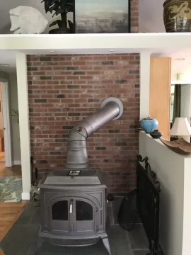

That Vigilant looks almost new and cared for.
You will need to think about a SS chimney liner if none there now.
Purchased it second hand...it was in bad shape...I sanded and painted it a taupe color..
Replaced gaskets etc...
Thermostat on the back is the best...I close it completely and put something against it at night..always coals in the morning...BUT it sits too far out into the room...has to have big clearances from 1/2 wall...and it’s very old! Maybe 1978?
Anyway I have an opportunity for a new one so I’m going for it...but def want to make the right choice for my space.. I do have lined chimney in my one story home with a hip roof

I think my pipe will go up 2’ then a 90’ then 30” back to chimney...so damper?
No need for pipe damper that I can see. A ceiling fan on the other hand is almost mandatory. The Rangeley is cast iron jacketed. It will be a much more convective (and much less radiant stove) which will help a bit with heat circulation and a more even, softer heat.
Do you think Rangeley will be a good choice for this space?
Yes, the F50 or F55 should work well and you're going to love the improved fire view.
