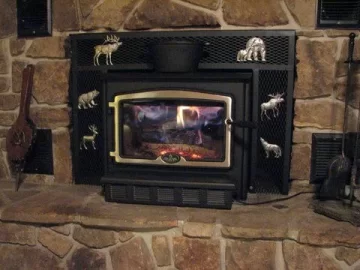

This is the surround I made....
That is beautiful!! I love the animal accents, very nice touch. What did you use to paint it? Did you weld it yourself? I don't have access to welding equipment, but figure I can bolt some mesh to a steel frame that I bolt together.
I got the metal from shop downtown to cut the 3 pieces of expanded metal. Then I welded it all together except the outer edges which is a "U" piece of sheet metal from the A/C shop - this allowed for movement for poor measurements. Sprayed it all down with high temp primer and then final coat of high temp flat black.
The animals I searched high and low for and found a place that was really cheap. Stamped tin, which I epoxied bolts to and also painted.
