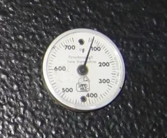

Yes, when our thermometer does a full 360 I pay attention but have hit 750º more than once.
And............where on that T6 stovetop do you place your thermometer? (Most therms don't do a 360).
In front of front and to the left of the flue, positioned so that I can read it through the trivet grate. I have a great old Sandhill thermometer on the stove. It came with our 1979 VC Resolute when we bought it and I have kept it since. Still accurate within 5º. The Castine was more likely to jump up to 750º if I didn't close down the air soon enough, though with locust the T6 will go there too.
