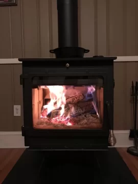

Kindling fire. Breaking it in to 300 for the first fire.

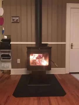

Here is a top down just getting into the bottom logs.

Anyone else noticed the ash dump is over the edge of the ash pan? When I rake the ash, I get a pile on the floor under the stove. I may have to make a little chute to guide the ash into the pan.
Most people just dig a couple scoops of ash out bypassing using the pan altogether...my ash pan is in the closet with Super Cedars in it ;lol
Get yourself a ash bucket comes with a little shovel. Alot less hassle
Reactions: RopeS
Seems like the thing to do.

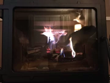

So I've been reading other threads on the dog house. Is it the 3/"16 hole facing the fire in the center of the metal box front and center or below in the crevasse that constantly fills with ash?
I ask because I see no difference in where I place my air control. In or out, turned or not, I get no jet. Even if I pile coals up front they don't glow any brighter while adjusting air flow.
I've been assuming it's the little 3/16ish" hole. The 1"X1" hole in the brick just in front of the doghouse stays full of ash.
What I'm burning now is a hickory blow down from three years ago that has been cut and split since this spring. I'll dig out some oak that has been split 2-3 years today and try again tonight.
I'm not familiar with your model stove in particular, but I would say that the 3/16" hole you found is the "doghouse air" hole.
Most of 'em have no direct control, wide open all the time...and there will not normally be a "jet" from this hole
There is a chance it could be the wood. No meter yet. I saw a YouTube video that shows a obvious difference between the air control being opened or closed. Full open shot a cyclone of flame between two logs in a N/S loading. I can rake up a pile of good hot coals to the front, turn out all the lights and there is no change in intensity or color with any adjustment other than cracking the door open.
What was the outdoor temp? Draft is probably still a little weak with the warmer weather many have had so far this year.
Upper 40s so far. Tonight should be around 40.
Getting it figured out. I'm crossing the wood to keep a flame instead of letting it get all jammed up.
2 Condar Medallions and an Imperial read 475 on top and 550 on an uninsulated spot on the side between the firebrick gap.
