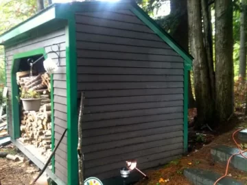

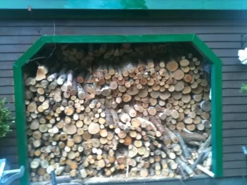

I have this woodshed that was built about 7 years ago. After spending some time on this forum I realize that this shed is less then ideal. We used to put green wood in it, expecting it to dry. I know that many of you move your seasoned wood into the shed, but in this case I'd like to make this shed as conductive to drying as possible. The only opening is on the front. As you can see I put a hole in the back and was planning on adding more (with screens). Before I do more I'd like some opinions as to where to cut holes... add vents etc?
Some thoughts I had:
1). Add a couple of "skylights" (I have some glass and I can be pretty crafty) on the roof in order to let the sun warm the inside- helping to dry the wood.
2. I have a few solar panels that I was going to rig to some fan(s)... where would be the optimal placement? (roof vent) (underneath) (sides) etc.
3. I suspect the easiest and best might be to remove the rear siding and simply leave the studs- leaving it open on both sides... I am hesitant to do that as the powers that be may not find that aesthetically pleasing...
Any thoughts or other suggestions?

That's a good looking shed, but as you said...doesn't look ideal for drying.
Couple thoughts come to mind:
1. Put in a ridge vent to let some air escape. That should allow cooler (dryer) air to be drawn in from the door...heat up and soak up some moisture, then exit the roof. I'm guessing the inside rafter area gets pretty hot in the summer.
2. I agree adding a vent opposite the door would help circulation, but I wouldn't strip the siding. Maybe add a couple louvered gable type vents on that wall?
EDIT: I doubt skylights would do much good because it looks pretty shady, but that might just be the pictures.
EDIT AGAIN: Can you use the existing siding on the back and louver it? Best of both worlds!

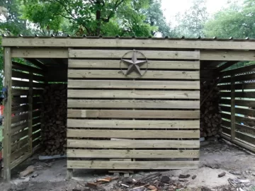

You could always do what I did on my shed that I built . . . I went with a conventional 2 x 4 wall due to the fact I had a lot of free lumber . . . but to make it look more appealing and still retain the usefulness as a woodshed I went with a vertical-running (I would have made Backwoods Savage proud) rustic board and batting minus the batting . . . it looks pretty good and allows air to circulate pretty well.

Why not just season the wood outside & use the shed to put the seasoned wood in for the coming burn season?
Venting will help, but even outside wood stacked tight takes longer to season in the center of the stack.
Some vents will help but using it for storing already dry wood might be more efficient.
Also Some holes in the floor may help create an updraft that moves air up thru the center of the stacks.

Like Jake, my shed siding is vertical with about 1/4" to 1/2" spacing between the boards.
I put my fingers up next to those openings and felt air flowing through, front to back and side to side.....it's 16'x10'.
As to your shed, if not too much trouble, take off the corner trim and siding, then reinstall with gaps. It helps. Oh, and split some of that stuff. It'll dry quicker.

I have filled this shed with all the dry wood I need for this season, to keep it out of the snow and rain :zip:

Thanks for the comments on the shed! I never realized it's "that nice", looking at it now though... yes it is! I guess it would be a shame to cut it up to much. But with lattice it might be able to be done tastefully. I have a number of spare windows from a remodel. My first idea was to turn it into something of a 'hotbox' if you will. Circulation would be from fan's (in the eves) and perhaps elsewhere.
Perhaps I am getting carried away with this. I know; move it outside and replace it with seasoned wood. I just really hate handling wood more then twice (cut spit stack- then burn in a year) but maybe I am just lazy.
Since I already purchased some solar panels and a DC greenhouse fan... where would you out it? Thought the roof... underneath... ? I'll try not to muck with it too much... but since I already purchased it... where would you put ONE (reasonably sized fan) in your shed?
Thanks for all your input guys! This is quite the site...totally enjoying the "cooler" weather... =)

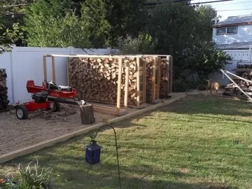

As others have already said - dont ruin that shed. Stack in nice, straight, single rows out in the sun and wind. It does not take alot of room to store 4+ cords.... and it can be neat and tidy. This pic is from a few weeks ago... there are now 8 stacks of 1/2 cord each. The area is about 30 x 10. This time next year- it will go in the 5 cord woodshed.
