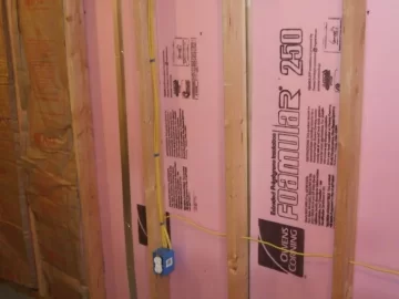

I installed the pink one 3/4 inch in my basement and then regular insulation R13batts, have lots of pics, here's one....worked great.

I put liquid nail glue on the concrete walls before placing the foam, the foam is tongue and grove so that helps keeping them and stack them up together.
I then sealed the seams with foil tape as shown in the pic.
That made a big difference in the basement temp....and I'm just installing my Santa Fe in the space......
