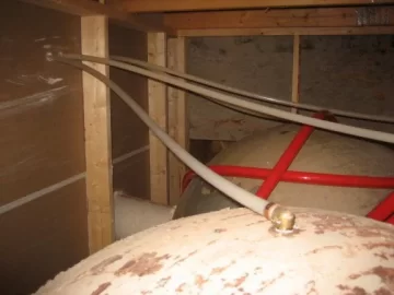

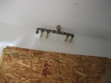

I always had my air problems in the lines that are in the house. Being a poor plumber I have a lot of dips in my pex running through the house. I fill my system with water in the house which happens to be half way in my supply line. I flush the lines both directions using shut offs and it seems to help me get the air out of the lines. I have two air handlers that don't like to give up the air so a hard flush seems to help. Also on top of my storage I ran a line (white lines in photo) from each tank to a manifold (other photo) with a air handler at the top because this is the highest point in my system.

Thanks for the photos Im not much of a plumber myself,I will try something similar to what you did .
Word of caution - before you insulate the tank after putting in air lines like I did - be sure to to somehow brace the lines. I forgot how much they will stretch when heated to 180 degrees and I had to try and lift the lines back in place after I blew in cellulose insulation. They sagged quite a bit. A wooden dowel or something similar would work well as you could zip tie the line to the dowel. The lines have to be fairly straight so that any air will move up to the air handler and not sit in a dip in the line.
