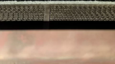

Hopefully the cat install is pretty cut and dry. I don't see how I can pull the old and add the new. It doesn't seem like it slides in. Almost like I need to remove something. I'll take a look at the manual.
I think you have to remove tubes and buffle. Did it once.
Does anyone know the best way to have the gasket tight when putting the new cat in?
[Hearth.com] Steel Vs Ceramic Cat. [Hearth.com] Steel Vs Ceramic Cat.
Use (painters) tape. It'll burn away upon first use.
Reactions: Highbeam

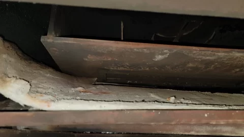

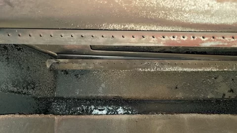

I believe the baffle is warped. I notice it's a little higher on the left side. 🤬
It looks like it simy sits there. I wonder if it's a warranty covered item.
It's a known issue, my got this way shortly after install. The dealer said bring it in and they will hammer it back to normal. i did it myself, after couple of fires it was the same way. Some guys pushed dealers to replace it. But it wraps again after a while. I just gave up. It doesn't seem like its affecting anything. It just dividing cat from firebox with wool laying on a top.
Lots of baffles fail to hold up. The ceramic ones in my noncat are bowed up in the middle about 1/4” away from the air tubes. Even the stainless steel ones that PE uses have been known to warp. Unless it actually causes a problem it can be just aesthetic.
