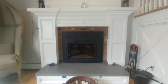

Here's another wrinkle for all of your calculations: the 26% tax credit. Hardly any non-cat stoves qualify, so if you're installing a new stove, you now need to factor that savings into how long it will take for the cat stove to be more expensive to operate than a non-cat. That tax credit extends the timeline quite a bit, and tips the scales very heavily in favor of cat/hybrid stoves.
At the end of the day, I wanted a PE Alderlea T6 more than I wanted an Ideal Steel, but the tax credit made the decision for me. With the money that will save me, I'll be able to buy 8-10 new cats before I hit the "break even" point, and there's no way I'll be living in this house, or running that stove for that long.
![[Hearth.com] Steel Vs Ceramic Cat. [Hearth.com] Steel Vs Ceramic Cat.](https://www.hearth.com/talk/data/attachments/287/287268-fe66cbdf3fc45cc8bd1668138eaae189.jpg?hash=uQPo17l5iu)
