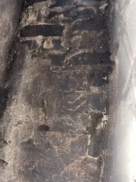

Well I may have found my ammunition. I was looking at the smoke chamber from the fireplace with the damper open (was going to clean t the fireplace/chimney next week) and saw a hole in the motor in the smoke chamber just below the start of the clay flue. Absolutely no way I can fit my body (or anyone else’s for that matter) up there to repair it. You’d have to take a section of the chimney apart inside the house. I’ll have to get some photos next week. I’m sure flue gases are getting in there and between the chimney layers. Not good. Even if I was just to put a liner in it would need to be 12” based of my fireplace size and there is no way I don’t think it’ll fit down a 9x13 clay flue. Never mind the cost of a 12” insulated liner
Picture difficult to capture but the hole is the grey spot in the upper middle of the photo. Clear as day with the naked eye
Edit: worse than I thought. Blocked the top of the chimney to cut off sunlight and saw the top 1/3 of smoke chamber motor just about all missing and holes in bricks. This thing is done. Pictures do not portray it well at all. The grey section of the top of the smoke chamber is a 2”x2” hole on the right side of the photo. Definitely needs a liner or liner/insert.
