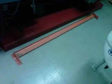

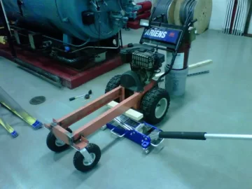

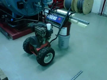

So I had an idea last year and just got around to starting it. A gas powered wheelbarrow! I traded a few thing that I made on the lathe for the tractor end of an Ariens 9/36 snow brush, I had some scrap steel at work that I had saved and bought 2 swivel casters from Harbor Freight for $24.00.
I plan on making the "bucket" out of wood, 2w x 2h x 4l or 1/8 of a cord.

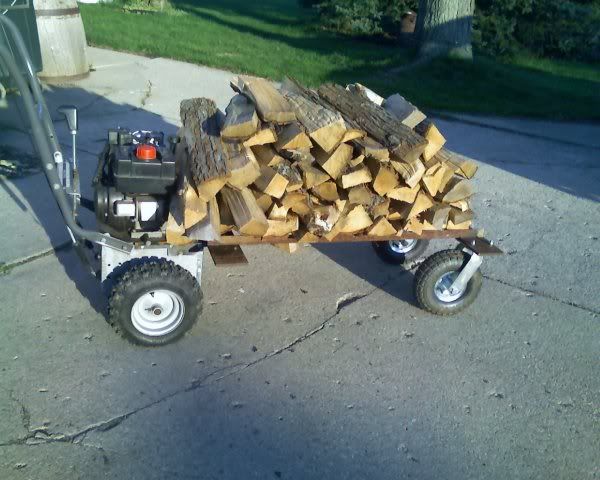

Looks similiar to mine:
[Hearth.com] Started a new project today!
Got the idea from someone else here on hearth.com.
Nice Shari,
How does it work as far as traction, and steering? I'm no engineer....and I had no plan, kinda flying by the seat of my pants!
Actually, the picture I posted was the first load. Since then I put uprights on either end of the flat cargo area as the wood tended to vibrate off the end or back onto the motor. Steering is a dog to say the least but can be accomplished if you allow for wide turns. All in all it's not a bad hauler. I've got 5 forward gears and 2 reverse so it can really 'go' if you want it to. :) Yours looks much nicer than mine but then again I don't weld - mine is bolted together. This summer I took of off the end upright and put our Otter sled on it and hauled dirt around the yard.

That's gonna make your life easier.. Both Shari and you have the same idea.. I think if you made the front axle so it would pivot or make the power end pivot you could then add steering making it easier to navigate.. I would imagine with 400-500 lbs. up front making a turn would require some serious force so steering with stops to prevent oversteer would work well.. Just my opinion as I like what the both of you have done! Now I want one lol especially when it gets muddy cuz it's really hard to pull a full wagon through soft ground!

I should add for anyone looking at this design - you do have to add enough structural weight to the cargo area to counter balance the weight of the power end otherwise the whole thing will just tip over backwards. And, yes, without a load in the cargo area I can 'pop a wheelie' in high gear. :)

PS Did you go with hard rubber front casters or pneumatic? I put pneumatic on mine figuring they would handle running on the lawn better than hard rubber. Yes, I have popped the bead with a load on trying to make a very tight turn.
