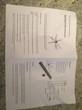

Thanks moresnow.
Here are my detailed instructions:
I will clip it down to 7” I think
Sounds like a good place to start. I need a replacement. I should have left mine a touch longer to begin with. Its well used equipment now and showing wear. Good tool.
Reactions: Diabel
The other side is blank.
