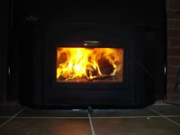

Your flames should look like this before you start playing with your air supply nice and hot.
I allso believe that your having a draft problem Can you take off your trim around the insert to see If you have a block off plate.If you take off your trim you should see the 5'pipe and a flat peaice of metal That is call your block off plate.Its there to help with draft and helps keep the heat from going right up the chimy It should be covering your old damper

OMG! my fire never has looked like that. I mean i do get a nice roaring fire with the draft open and the door slightly open a bit but no way does my stove come even close to that fire when the door is closed. I will look for the block off plate but is suspect none will be there. Will the inspector from the city require this? Is this for code?
