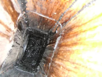

For an update. Called the chimney people and the 1st appointment I could get was from a place about 50 miles away in January. I bought some fiberglass rods to see if I could clean from the bottom clean out door up, instead of from the top down. I could only get the rod in a little less than 4 feet and it seemed to get stuck or stopped by something. After a few tries, I got my little led headlights and put them in the clean out and took a picture with my camera. It's hard to tell, but to me it looks like a solid block of creosote.
If this is true how on earth did this happen? The chimney was cleaned with a brush and the stove has only been used 6 times or less this year. The first couple of times it burned fine then it started not drawing and smoking. In the photo, the walls of the chimney look clean until you get to what appears to be a solid block of creosote. I can't imagine how this could have occurred unless something got into the chimney and the creosote built up around the blockage after just a few fires. I have a new chimney cap over the top of the chimney, so I don't know how that could have happened. Any ideas?
Take the brush off the rods and see if you can knock it out with the rods only. Then see what falls out. How well does the clean out seal? Cold air coming in there then mixing with the hot exhaust from the stove could be a problem. Gaps at the thimble pulling cold air or a crack in the liner doing the same thing? Chip it out and see what you have first though.

Thanks for your well thought out advice. I found someone (not a professional) to climb up on the roof and I gave him a long piece of pvc pipe and he chipped out the blockage (actually two) and then cleaned everything out with the brush. He took a light and said that everything looked clean. I cleaned off the sides of the cap which had some creosote build-up. It has a solid top, but the sides had some creosote.
He looked at the wood and said although it wasn't green it wasn't really dried as much as it should be. I have a moisture meter somewhere that I just found last week, but can't remember where at the moment. If I find it I'll check and see.

What was the stuff he knocked out like? Shiny and dense or something else?
I went back and looked at your picture on page one. check behind that trim ring at the stone wall to see if you have gaps there if you have not already.
I'm sorry about not replying before, I just saw your post. The clean out space isn't hot, or even warm and I have a hot fire going now. I've been trying to burn really hot to help with the creosote.
