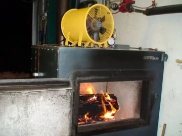

If you could find a ventilator fan like the unit on top of the boiler and vent it out the side or back of your boiler room , you will never get smoke in your face or boiler room / shed . Even on low speed it sounds like a jet engine , it will blow the smoke 20 ' straight out my garage door . keeps my lungs & room much cleaner. I will try to post a video on You Tube soon.

Hey Anthony - this looks great. Where did you get that fan?
Pete
Pete

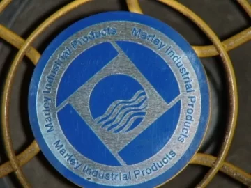

Pete I found the ventilator fan at a local electrical supply , try to Google the name on the label , if your interested I could get more info from the supply house. Anthony
(broken link removed to http://www.marleymep.com/Develop/Products/PortFan/MipAirHog.htm)
