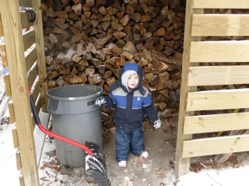

Well when I built this I just had cut and split about 2 cords, being brand new I just had to putsome in the shed, being new and all,I am burning the wood that I seasoned outside. And I hope some day that cord I stacked in that new shed will season, So if you want to season wood , you need to do it it outside. :zip:
