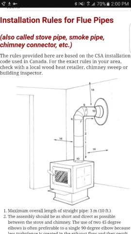

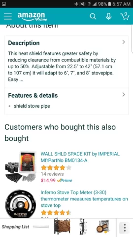

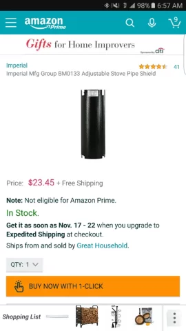

I probably misread something somewhere. I'm at 16 inches ( 2 inches shy of code ). I'll place a short heat shield in that section. Seems a better option than reducing 3 to 2 to 1. I just need to find a heat shield short enough. Everything seems too big to fit but they reduce clearances to 50%.

I can see how that diagram could be misleading........because it's wrong. If you read through the written part on that guys site/article you will see that he specifies 18" clearance to combustible from single wall, which is correct.
You may have to modify or build a shield to fit your needs. I'd definetly recommend checking in here with your plans on it. And not going by the site you got that picture off.
I'm going to fire that guy off a e-mail about his diagram.
The fellow got right back to me and already edited the numbers out of that pic.
