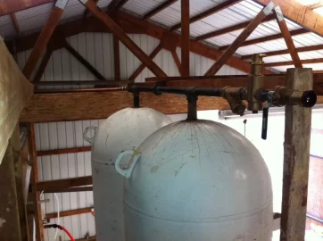

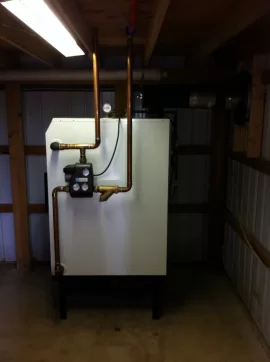

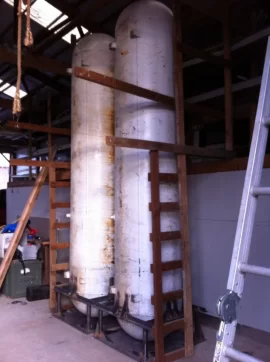

Thanks for the advice. Ted Kestor supplied the tanks with the fitting welded and pressure checked. They were put in place yesterday. Today I am sourcing fittings to make the connections. The tanks are sitting on a 4x8 concrete pad that is 6" thick. I have some concern that their may be settling and therefore some change in position between the storage tanks and the rest of the system. For that reason I was planning on using Pex. What is the concern with doing this?
I had thought about debris in the boiler water. Is there a filter / screen that is commonly used?
my pad is 6" thick but 25x50'. my tanks are vertical on 3/8" steel 9sqft bases, with 5 points of contact to that 3/8" plate. no cracking or settling. PEX is rated for 200*F. Boiler has potential to heat up water to a greater temperature than that. most dont push thier boilers that hard, but there is the potential if you accidentally overload it or one of the safety measures fails. PEX is acceptable for storage to house run and return to boiler. a min X' (12') is recomended pipe after leaving the boiler. i ran all copper from boiler to storage, and a few feet on the return just so it looked nice. i have pushed my boiler just over 200*F.
Wye-strainers for debris. in a year and a half i have yet to clean mine out as the flow seems fine still. i will try to get to them before this coming heating season. i have one right before water geos into boiler and another right after water leaves storage to go to house. i did flush my tanks a couple times before filling them up for good.
get a thread started with some pictures as you go! that way others can comment as you go and give advice if needed. everybody here has opinions but we all want you to be warm come winter time!
