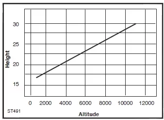

What altitude are you at? The chimney height requirement goes up with the altitude. 58F is pretty warm still. I think you will see better performance as the temps drop.
begreen, I am at about 5700 feet. I think you are right about better results once the temps go down.
I am going to do a little more research on the dynamics of draft as well.
Vermont Castings stoves are somewhat draft sensitive. According to their chart you would need 22ft of chimney for the equivalent of 16ft at sea level. If secondary performance doesn't improve with cooler temps of 45 or below, I would consider adding more chimney.
Interesting. I just did a quick search. This site: (broken link removed to http://www.icc-rsf.com/en/design-considerations-for-the-excel-chimney) from Excel indicates that for every 1000 ft elevation, you should add 4% to the minimum sea level height of 12'. That would put the OP's minimum at about 15' assuming no tee's, bends or horizontal runs. A little better than I have here with 13' at 750' elevation. My draft is a bit marginal especially on warm days and a little smoke leakage when I open the door too quickly, but still functional.
Trooper, do you have any offsets, horizontal runs or tee's in the system?
This varies. Pre-EPA stoves may get away with 12 ft. but not many EPA stoves will. The minimum sea level height for his stove is 16 ft. Nappys like a fairly strong draft.
