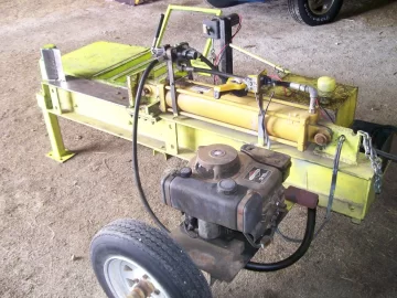

Thanks Jags, Yes it's a 5hp, 3/4 straight shaft. I looked at the husky at TSC, they had the exact motor on the 22 and the 27 ton spillters. I initially looked at an older 7hp honda, it ran,looked pretty rough, and the guy wanted $150 so I passed. With what I have, what would be your suggestions please Thanks!
I'm kicking that around swagler I've had three back ops in the past and thats why I'm doing this project, I can't take the hand splitting much more, although I enjoy the exercise it gives me.
You are limited to a 11gpm pump with that engine. 11 gmp on a 3.5" cylinder will be okay. On a 4" it will be slow (probably around 18 sec cycle time).
Thanks! I'll start doing the search on parts!, Thanks also for the heads up on the wedge wings, I did think of that, they are only 3/16", If I crush them I'm just gonna burn them off.... I thought it may have been a good idea, but after I welded them on, I thought it was "really" not needed.
I saw that, hence the suggestion. Even a hunk of bar stock welded in the middle of the spread would help a whole bunch. I like my wedge - it is very efficient at splitting open the tough ones.
If you have any more of that plate you made your wedge from you could cut it on a bias and build your wedge wings from that. They would lay up nice and allow for a 100% pass on the back side and bottom. Could also add some support up top to finish?? Just an idea. I really like the way they help with tough splits and also pop the easy ones quicker so you do not need to go full stroke.

Thanks. It was designed for dealing with the big stuff. All but unstoppable and I don't have to worry how I put the log in or read the grain. Set it on the beam and pull the handle.

I'm just a home owner, I was cringing at the thought of spending $1500 + for a splitter. But then I thought of the month's I layed in pain with my back "SCREWED" up, hence this project
Swagler, I was scrounging around today at work, got thinking of bending over 1000 times in a hour or two, so I think were gonna see a catch tray, and possibly Jags style lift mechanisum It'll look like something from a transformer movie
