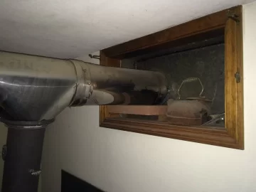

isnt there space through the old window?

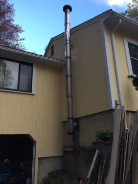

There is but when I install the new flue I was going to have my mason block it up so I can use a thimble and route it through the wall properly. I don't have to block it entirely but what do you suggest? I'll take a few photos of the whole system so everyone can see what I'm working with.

Finally got some photos.
