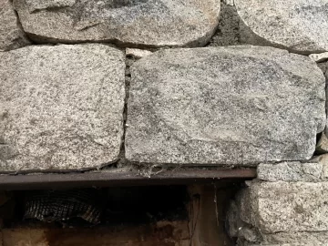

Right now the 20" opening height is the deciding factor. If the big hearth was removed, then a big rear vent stove like an Ideal Steel or Progress Hybrid could be installed at floor level. Another alternative would be to raise the lintel. If the interior hearth floor has also been built up, then it might be removable, but it's important to know what's underneath this first.

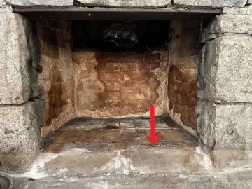

Instead of going up.. . I went down.
I took out the bottom layer of brick, bringing the hearth level with the firebox.
I've also started chiselling at the hearth. The hole is 2 inches deep and still concrete.

If you want a bigger firebox, a Progress Hybrid sounds like a good option, or if you want a just-slightly-bigger firebox, a Fireview might work. They both need 26" to the lintel, but it sounds like you could get that by removing the front hearth (and still have a little wiggle room to install a lower hearth). The Fireview is only 20" deep, while the Progress Hybrid is 25" deep - both are more than your target 12", but because they're side loading, they don't require as much of a hearth in front of them, which might balance some of that out.
Removing brick seemed to work.
Under the brick was several inches of sand. I went down about 3 inches and thought that was good enough.
With that layer of brick removed I was able to get a Pacific Energy Super Insert installed, with about 1 inch to spare all around.
