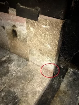

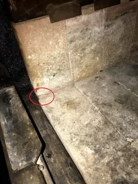

Hi all,
So I just installed my Enviro boston 1700 insert and I have two cracked firebricks. They are cracked all the way through when I shift or jiggle them. Should I leave them or replace them?
thanks!

I'd probably leave them. If they are very loose you could remove each brick and fragment and exchange it with a bottom brick.
Given the location and that it’s just the very wee corner, I would leave them. You want to change out the bricks that might actually fall into the fire!
Ok, I will leave them and monitor. I have not used this stove yet. Might do a test burn this week to ensure everything is working ok. Rather know now than wait until fall. This way I have the summer to fix/review anything.

For $6 I'd get 2 new ones...

There is absolutely no reason to replace them
Yes. If they are just cracked in half, they wont make any difference. There is a crack between every other brick in the stove and It fills with ash. Does not matter at all.
They just have the a tiny bit of the bottom corner cracked
Ok, Im on my laptop so I guess I could have scrolled up to see them. I cant believe a thread was made about THAT! I think in some stove manuals they tell you to replace them when they are worn in half or a third of original dimension.
