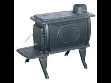

I heated my insulated garage for several years with an older version of that stove that I suspect was actually made in USA. Worked great.
I found it easy to control the fire in fact easier than my EPA stove of today. It certainly was a simple stove although a smoker when I choked it down. Never felt it would burn down my garage due to it's controllable nature.
You probably had one of the more original stoves that are much higher quality castings and fitment. The cheap us stove company ones really are very bad

I only reload one or two pieces at a time, once it is up to running temps. I just dont feel safe loading it to the gills. Its more trouble to load so often, but I can control the fire and burn rate with my damper.
Guessing you mean key damper as well as the stoves front damper. If not adding one will make it more controllable. These straight through box stoves can get pretty hot. The originals usually had a draw slide stove damper that was not very tight. Not sure what’s on yours. In my seat of the pants days my first stove was one of this design. It could be easy to get the pipe glowing. If you aren’t in a position or don’t have the desire to get a more efficient and better built stove you are right not to feed this stove to the gills. One nice thing about a lot pre type stoves is that you can burn one or two sticks, just run it hot enough to avoid creosote trouble. Of course I have to echo the innumerable calls to burn dry wood.

Its not a burn barrel, but its just a small cook stove/wood burner. Is it the safest out there? NO. Does it work for me, YES. I just like the fact that its basically a cast iron box, with no fancy stuff. I load wood, burn it, it heats my house, and I clean the flue often. Would I like a new enameled stove? YEP. But I make due with what I have, and Im happily warm.
Caution is the right way to run one of these. They don't belong in a house IMO due to the poor air control and low quality castings.

No one said it is unsafe to burn in something with doors. Or that it's safe to burn an open fireplace. Either can be very safe if they are built installed and operated correctly. The problem is your stove is extremely poor quality. I have seen many of them crack very badly simply because of the poor quality castings. We also know nothing about the install and it's safety. But the fact that you imply it would cost allot to install a new stove tells me your setup may be questionable.
its ok.. hes been around fire all his life..
Your influence and command on this site is well known...... surely you took pics of these many cracked stoves to share and educate us so the danger that is preached here is also backed up? Please post them up.
No I don't have pictures. I never felt the need to document the fact that a cheap Chinese stove was poor quality. It's very well know by pretty much anyone who has touched one. Many of them were even sold with disclaimers they weren't for use in houses.
