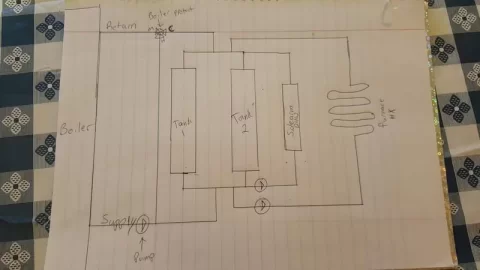

I've been trying to figure out my plumbing on this project and I came up with this.
[Hearth.com] Questions about next year's project
Would it work like this or would another way be better? Please any input would be great.
Also would I need a heat dump zone if I start doing batch burns? I'm assuming, yes. If so what is the best way to accommodate that?
Could anyone help me with my drawing above? I feel an early spring coming this year, for some reason, and I want to start getting things in order early on, if possible.
