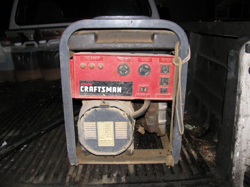

I'll jump in. I ran my Englander furnace fan, sump pumps, refrigerator and chest freezer with my cheapo (free to me actually) Craftsman/Generac 4.7KW generator for the first time last night. I just ran a 12 gauge extension cord into the basement from the genset to a three way splitter. One cord went to the furnace and the other to one of the sumps (the drains are all connected so it still pumps everything out, just slower. After the sumps were empty and house was warm I plugged the freezer and refrigerator in until the compressors kicked off-then back to the sump and furnace. Not an ideal setup, but it did the job for the 8 hours or so we were in the dark. This summer I'm finally going to install an input plug and interlock switch so that I can feed the essentials through the main panel safely. One question though-since I'll be feeding power through the whole house and will be able to use outlets, how do I know its safe for things like computers and TVs? Is there some kind of filter or surge protector I could put between these devices and the wall that would help? This is the generator BTW:
