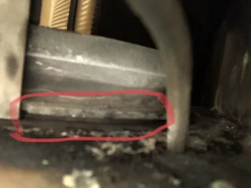

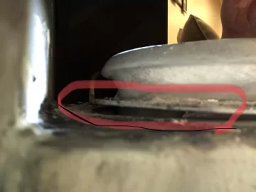

Yes there is a clean out but I just wanted to make sure I got everything and I did. I will attach a picture of the gap in my fire pot this is what it has to be. Everything else is sealed and cleaned
[Hearth.com] QuadraFire classic bay 1200 fire pot filling This is with no fire pot gasket. This has got to be my problem! I have been messing with this stove forever! Somebody back me up?
Yes that would cause a major leak. And kill the burn
Told you from the start when you said no gasket that this is a major issue. kap
Appreciate you letting us know. kap
As long as everything is clean and settings are as good as can be, it's all it can do. you can try +4 but watch flame. Try a couple bags of another brand pellet. May have to help it get to a temp with other heat, to give it a chance. kap
