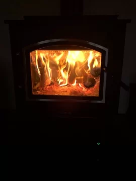

So there are two guys with these stoves going in here. Any updates on these stoves? Have a chance to pick one up for $2100? Feed back would be greatly appreciated.
Wes, I called my dealer last Friday and they were going to call me back this week and never heard back from them. When I did talk to them on Friday they think it may be a bad thermocoupler. That is one of the heat sensors in the fire box. They agree it shouldn’t continue to fire for the 2 hours. Hoping we can get this dialed in but we’ll see. I am not sure on the jumper wire as the dealer installed it.
I have turned the electronics off and am running it manually right now. Just pulled the pin out of the damper control and you can control the air manually. It is working good now. Room is up to temp and flames just licking the glass. Nice slow burn! Will run it this way until the dealer can figure things out.
