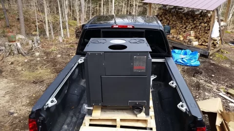

I stopped at my friends warehouse to take a look before I pick it up tomorrow. The manifest says it weighed in at 740 lbs (packaging and all). So does anyone know where I can get a good deal on Wheaties?

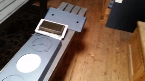

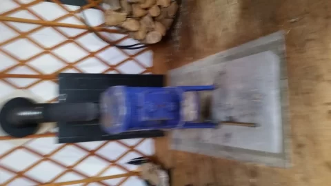

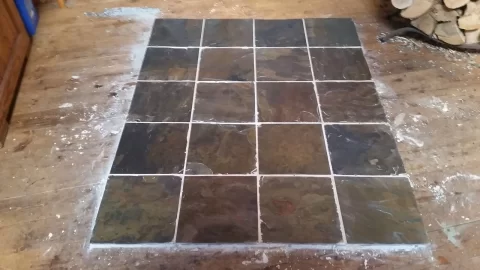

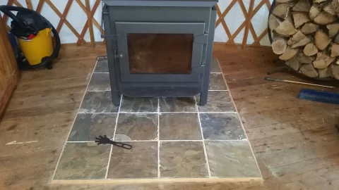

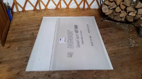

Here is a small timeline..
[Hearth.com] Pulled Trigger On Ideal Steel Hybrid [Hearth.com] Pulled Trigger On Ideal Steel Hybrid [Hearth.com] Pulled Trigger On Ideal Steel Hybrid [Hearth.com] Pulled Trigger On Ideal Steel Hybrid[Hearth.com] Pulled Trigger On Ideal Steel Hybrid [Hearth.com] Pulled Trigger On Ideal Steel Hybrid
Still have to trim out the hearth and actually put in the stove. That's next weekend. :)

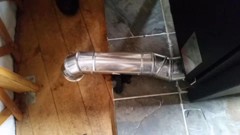

It looks like you have an outside air kit?

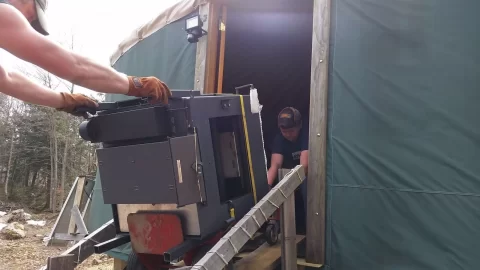

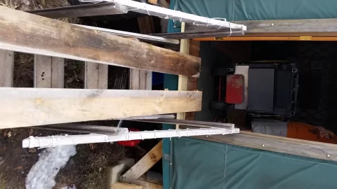

My sons and I, along with my brother got it on the pad last night. Going to finish up the install today and get it fired.

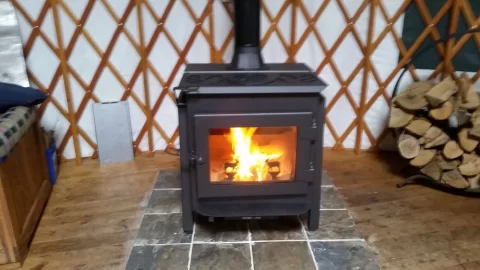

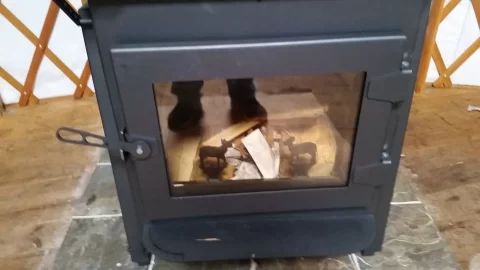

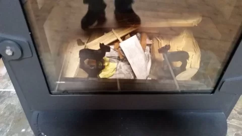

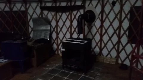

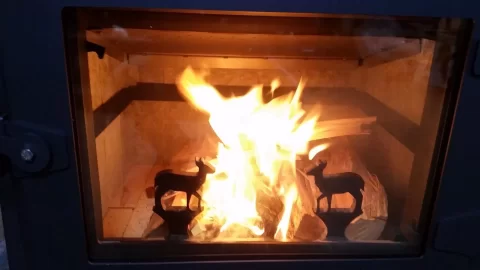

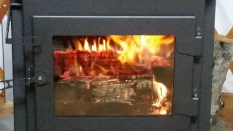

Here it is. The first night it was 20f outside. The yurt got cold after about 7 hours with the damper on 50%. The next night, it got down to 28 and the yurt was warm for 10 hours at 2 clicks above 1/4. I have some tinkering to do with it. Right now, it seems like the fire goes out at 1/4 and the heat goes down (though slowly). When I get some colder weather, I will have more time to really dial it in.

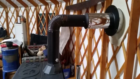

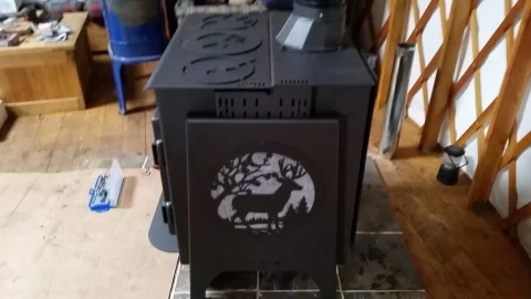

Beautiful stove. Here are some pics of the final install and OAK:

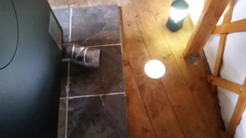

You could probably improve draft by shortening the class A coming through the yurt wall off the tee. Then change the 90 out for a couple 45's with an offset piece.
I thought of that. Not sure if there is any issue with the draft at the moment, seems to work really well, except when I have the dome of the yurt open. For whatever reasons of pressure and thermodynamics, it messes up the draft.
I may switch to two 45's at some point.
For better draft you'll want that horizontal run to be as short as is safely possible.
Yes, that makes sense. The same thing can happen in a house when you open an upstairs window. The exhausting warm air creates negative pressure down below.

You don't want to run it at 50%. Way too much primary and secondary air. Even at 2 notches above 1/4 it is considered a high burn rate. You will have more success slightly under 1/4.
Close the bypass and slowly bring it down in stages to about 1 notch under 1/4. The box will go black and you should notice more heat coming out the front and top. Later in the burn you may get some secondary activity. Adjust it more or less as you desire.
I do know that above 1/4 you start eating wood much quicker.
