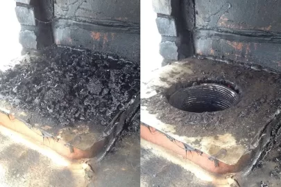

I paid a chimney sweep to get on my roof last weekend and clean from the top down. Here's what he found. View attachment 242531
He reported that the pipe was almost totally clean, until the top 6-12", then it was clogged almost totally shut with creosote. Happily just the crumbly flaky stuff, no glazing.
I pondered how this build-up occurred, since I swept with the soot-eater after last season. He mentioned that he measured 32' of liner height. I went downstairs and counted my soot-eater rods, and I have 8x 3' rods, so 24' length. So apparently I have NEVER swept the full height of my liner, and this represents 7-8 cords of buildup.
So now I need to shop for 3 more extension rods (or 4, since they come in sets of 2). I understand there are black and white rods. My current set is black - should I stick with those, or can I mix and match white and black? Liner is straight up after the first bend
