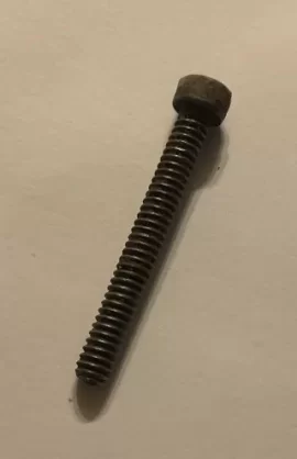

This is one of the ones that didn't fit.

There was a guy on YouTube that had the same bolt breakage, and he just tapped the handle for a different bolt size that wasnt a shoulder bolt. In my PP70, there is a bolt like the one that you show above that didnt fit, and there is a steel tube around it as a roller to apply the force to the seal. So, a couple of options if it ever happens again...
