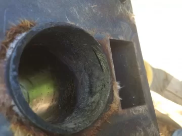

Well THAT is a sobering thing to read -- thanks for the warning! Down in the tube, m I've been only using the 90 degree needle pick. Sounds like I should keep it that way.
The tube wears out just from the pellets passing through so you don’t want to “help” wear it out. This was mine before I replaced it.
