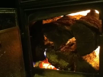

One other trick that I am learning for the overnight load -
1. clear out the coals in the back
2. put a large split or round in the back
3. pile the coals on the sides of the spilt
4. put in the lower tier, middle split
5. pile more coals on top and in between those two splits
6. most of the coals are now stashed around on top of those spilts
7. pack the rest of the stove
get the stove up to 500 F and button her up for the night -
