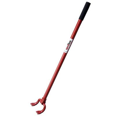

I have quite few pallets I want to bust up and have access to about as much as I want so I was thinking of buying this tool

The Deck Demon, or a cats paw deck wrecker will do the job easy for sure if you want to spend the money
I just bought at "Pallet Paw" on eBay for about $65 delivered. Pretty good tool for busting up a pallet while keeping the wood reusable for projects. Takes about 5 minutes to break one down if you're being careful not to damage the wood.

Here's the guy's website - but I think he sells them slightly cheaper on eBay.
http://palletpaw.com
