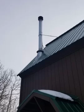

Is the cap missing outside? Only thing I can think of. When you turned the air down you mean it had no effect on the fire? Sounds like your door wasnt latched completely to me.

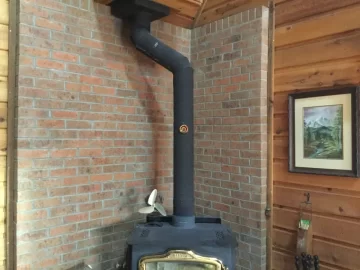

The single wall black pipe doesn't look very discolored (it would fade white) if it was burning very hot.

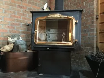

I'm guessing this is a Harman TL2.6. It has a bypass damper (lever on the left side) and an air control on the front. Was the bypass damper left open when it had high flame? It should have been closed if the stove was getting hot. The stove may be fine, we need more information. You could add a key damper inside the stove pipe for a bit better regulation.
Wall shield doesn't look like it has air gaps in it for venting, single wall pipe needs 18" from combustibles, a proper wall shield will have 1" spacing from the combustible wall, 1" from the bottom, cant see the bottom but it looks like the top of the brick was capped with a piece of trim making it null as a shield since airflow is blocked behind it.
The cap is still there. When we turned down the dampers, the flame seemed to be unaffected. You may be right about the door. I have since opened and closed it and didn’t notice it was open, but it’s possible. Thanks for your help!
You are correct about the location of the side damper and the air control. (Impressive...you know your stove stuff!) We closed the side bypass damper and the air control and it didn’t seem to make a difference. In the past, the damper and bypass did the trick. It seemed like there was air coming from somewhere. We could add a key damper, but this was a change since the wind storm.

Here is a pick of the outdoor stack. May help.
