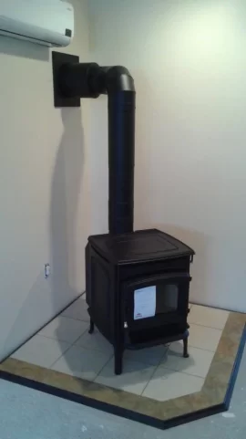

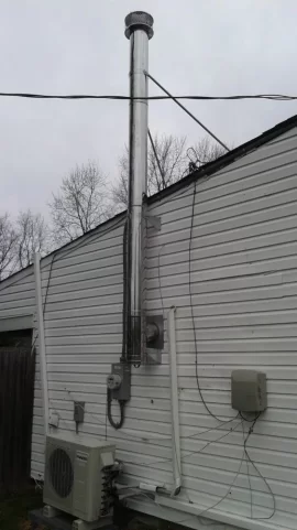

I'm getting a lot of down-drafting, odors, and smoke spillage. I know my set-up isn't ideal, and was wondering if anyone else with a similar set-up experiences these problems. How did you guys remedy the situation?
Here it is:

Could be the outside chimney is not tall enough, combined with milder temps = weak draft.

A lot of what I've been reading online indicates to this being a completely ill-advised set-up. Stove is on an outside wall with the chimney not in the heated space, it has elbows and a "T" that restricts airflow, it's in a one-story room while the rest of the house is two stories, etc.
But with the layout of my house and the building/mechanical codes of my township, this is the only place it could go.
I'm wondering now if there are ways to overcome these issues.
Building codes did not allow the chimney to go straight up through the ceiling?

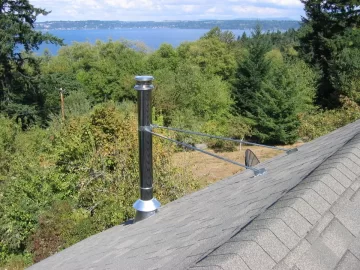

What 10ft clearance? Do you mean the 10-3-2 rule? In that case the chimney just needs to go a little higher until it's 2ft higher than the nearest roofline ten feet away. This was the case with our installation.

I'm sorry, I misspoke. If it were to go straight up through the roof, it'd be too close to the windows on the second story.
At least, that's what the company that installed it told me.
Atleast take the one 90 deg bend out and replace it with (2) 45 deg pipes
That still doesn't sound correct. The chimney pipe can be within 2" of combustibles. Going through a second floor means the chimney would need to be chased (boxed in) but can be done.
The room the stove is in is a one-story attached garage that I converted into living space. The rest of the house is two stories. If the chimney goes straight up through the roof of the one-story space, it will be practically right outside of the windows to one of the bedrooms on the second story of the main house.
Sorry if I wasn't clear.
Ok, looks can be deceiving and the picture doesn't show the 2nd story. I was thinking if the stove pipe went straight up it would only be about 2-3 feet closer than it is on the exterior. If the second story is within 10 ft then the chimney would have had to go up to 2' above the second story roofline.
Best thing you can do now is try to soften the 90º elbow and maybe add another length of pipe and a second brace.
