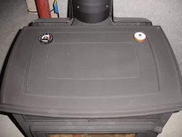

Did your stove start out shiny and then go dull like that after first burn?

I suspect the stove is fine . . . it seems pretty normal for matte black painted stoves to become a little less black over time. I suspect, as another, it's the paint curing. How is the smell?

I just bought it! Had install yesterday. And it looks that way after one burn.
So trying to figure out if that's normal for a f55. But nobody who has one has replied yet. So will wait to see. I'm just hoping we didn't do something wrong.

Most stove manufacturers now call out a mounting location for a thermometer, and a maximum allowable temperature at that location. If you didn't exceed that, then you did nothing wrong!
No experience with Jotul paint (all of my Jotuls were either factory enameled or aftermarket re-painted), so can't comment on what's normal for them. But as others have said, most painted stoves dull out as the paint cures. Matte black is normal, unless you have metallic paint or enamel.

F-500 Oslo . . . Ashful makes a good point . . . if you don't have a stove top thermometer it's not a bad idea to get one as they can be pretty darned useful in making sure you don't overfire your stove. I also am a big fan of having a flue thermometer as well to help me run my stove more efficiently.

We just ordered a stove thermometer. Did not have one. Will think about getting one for the pipe too.
Do you have links to share for good thermometers?
Just hoping we bought a good one. Thought I'd ask what you guys use.

Condar.

A probe on double-wall is the way to go. I use that more than the stove top temp to tell me when to shut down or open up the air. Using only the stove top temp is a bit like judging a car's speed by the tachometer. That works fine on level ground, but can be deceptive if going downhill.

Oh and I wouldn't worry to much about the paint so far, see what it does with the next few fires, it will stink with every new high temperature..

I lit my stove in November the first time with all the windows open and fans going. Followed the manual and lit progressively hotter fires.
Then, each time I burned it hotter, I got a little more smell. Now it's all good.
Mine is flat black all the way across now.
I've used both an expensive Tel Tru and a Condar. The Condar is fine for wood stove use. Here is where the manual says to measure temp:
