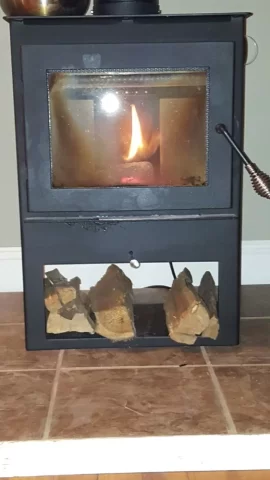

Ok, i lit the 17 today when i got home from work, i got it up and going good in about 15 mins.i cracked the door for 2-3mins to make sure it got the draft going. I ran the primary air open until the single wall got over 250 exterior temp. Then throttled back, steping it down to about 5/8 the way closed and left it burn. Single wall temp fluctuated from 250-310, stove went to 550 and hung there for a while then burned down. Loaded and repeated. Its burning consistant at that setting. I measured every piece of wood i put in, all 14-18 % moisture. I am still getting soot on the glass cant figure that out. [ATTACH176761[/ATTACH]

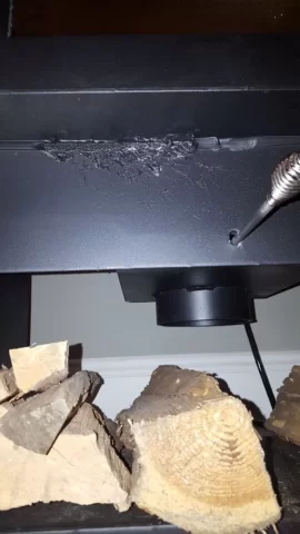

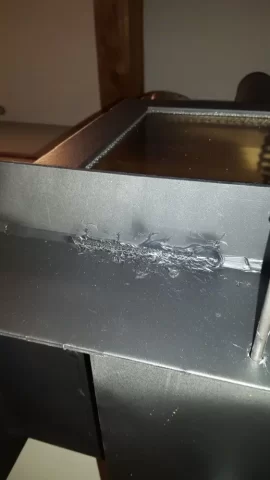

So i just noticed when i took that picture there is a calk seam under the ash lip that looks lokes it is blown out maby? Not sure what the calk is sealing? Or why it looks blown out? Should i re-seal that with fire calk?

Paging Mike Holton. Call in the lobby for @stoveguy2esw . Some welder drank his lunch?
Haha yeah right, its not a weld. (I am a welder by trade) upon further investigation, The ash lip appears to be stitch welded on either end underneath, and then filled in with calk in between, not sure why it looks blown out? The ash lip appears to just be a plate stitch welded on the exterior of the stove body, should not be a problem.
actually that looks like silicone, what it looks like is someone was blowing the stove off (which usually happens before that gets caulked just before going into the paint booth) I guess the guy who caulked it got ahead of the guy who blows the stove off before that, shoulda cleaned it off and recaulked it though, looks pretty ugly.
to the OP, if you want , contact me and we can discuss how to clean that up and make it more presentable
