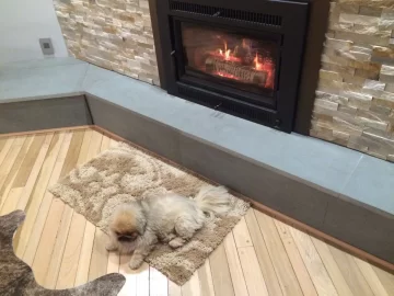

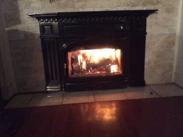

Modern looking inserts: Pacific Energy Neo 2.5, Osburn Matrix, Large Flush Hybrid Insert from Travis industries (Lopi, Avalon, FireplaceXtraordinaire)
The Regency insert is extensively discussed here: https://www.hearth.com/talk/threads...-ci2600-fireplace-insert-risky-costly.132252/
thanks i like both the osburn and the LFH insert.
I recommend a forum search to check for experiences with both units. The LFH is somewhat larger with a 3 cu ft firebox and has a catalyst which means added care about the wood you are burning.
