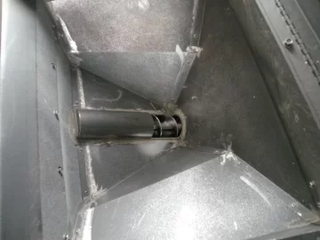

I do not have that plate at the intersection of the hopper and the auger. Here's a picture of the auger in the empty hopper. [Hearth.com] New Mt.Vernon AE pellet stove owner - not as toasty as I thought!

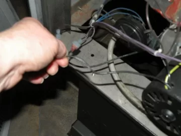

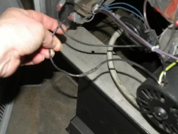

Apparently the last time we pulled the combustion motor to vacuum the exhaust path, we caught one of the electrical wires that supplies the combustion motor in between the gasket and the housing, and tightened the motor mount down on it.
The portion of the wire that was entrapped was flattened when I found it, with some fibers from the gasket stuck to it. I brushed the fibers away. The rubber wire casing, while flat, appears to be intact. I see no bare wire. The wire is not hot to touch, neither at the flattened part nor anywhere else on the wire.
The combustion motor seems to be running normally. Everything sounds as I expect it to sound. I see no smoke coming from the motor nor from the wire.
I'm thinking we dodged a bullet here.
I've attached a couple of bad pictures. It's an awkward place to take a picture; our stove is set into a corner at an angle and there's not a lot of space on either side.[Hearth.com] New Mt.Vernon AE pellet stove owner - not as toasty as I thought! [Hearth.com] New Mt.Vernon AE pellet stove owner - not as toasty as I thought!
If anybody knows any reason why we should replace this wire, splice it? or, if we can't, replace the combustion motor, please tell me!
If there was a possibility of getting some shrink tubing over the damaged wire that would be my preferred way of insulating it. Otherwise, I would wrap it with electrical tape.
Aha. Electrical tape. I can do that!

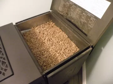

I started the stove with 40 lbs. of Turman's at around 2pm. Based on a 4 lbs./hour feed rate, which is supposedly what will happen at setting number 4, then we should have an empty hopper at midnight. So, we shall see!
Id wrap the wire in electrical tape but if it was causing an issue you'd know by now. The Mt Vernon AE is the only quad that doesnt have an adjustable feed gate, it regulates pellet feed via the wall control through the flame height adjustment option.
That wire is all wrapped up in electrical tape. Stove running like a top on feed 4 with a bag of Turman's. (Glad to be finished with the ashy pellets.) There does not appear to be a problem with the combustion fan; it is running smoothly and quietly. We'll see how long it takes the stove to burn through this 40 lbs. bag of pellets at feed setting 4!

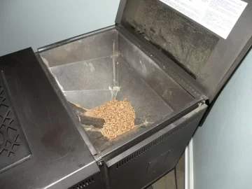

This is what currently remains of a 40 lbs. bag of Turman's that was placed in the stone cold empty, freshly vacuumed hopper at 2pm today. The hopper holds 55 lbs.
The feed rate has been set exactly on 4 since 2pm. According to the stove manual, a feed rate of 4 should burn 4 lbs. an hour.
This means that at midnight tonight, this hopper should be empty. The attached picture was taken at 9pm. Do you think that this hopper will be empty at midnight? No?
Me either.
The feed rate is off on this stove.

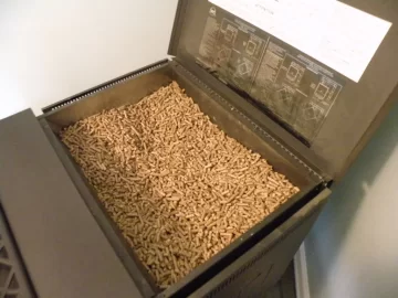

Previous 40 lbs. bag of pellets was put into stove, stove started on feed setting 4, at 2pm on Friday, 12/13/13. The stove was run continuously on feed setting 4, and that 40 lbs. bag of pellets was used up (with the exception of a scant handful to keep the auger from emptying completely) at noon on Saturday, 12/14/13. This one bag of pellets burned for 22 hours at feed setting 4. Auger interval: auger turns once every 8 seconds. It turns for 2 seconds, then sits idle for 6 seconds. At the end of the 6 second idle period, it turns again.
At noon on 12/14/13, we refilled the hopper with another 40 lbs. bag of pellets. Feed setting 4.5, the very upper limit of the "acceptable range bracket" that is painted above the numbers on the feed rate dial. This range bracket spans the distance between feed settings 3.5 to 4.5. The auger cycle at this setting appears to be a 7.5 second duration: 2.5 seconds on, followed by a 5 second idle interval, after which the auger turns again.
