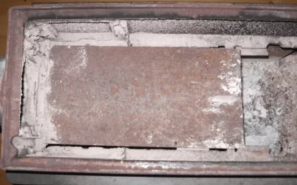

A temporary fix that works until snow and mud seasons are over is what I'm looking for. Until then getting a new or less used stove will be a logistical challenge. I did find a steel plate under the stove that's about the right size to be a baffle. It's certainly not the original baffle plate, but it does look like it was specifically cut to be an approximate replacement. Now that I know the top of the stove is removable, I was able to put in the pseudo baffle, like so:
[Hearth.com] New member with (new to me) old Jotul 118
Now the flue temps are much lower, the air intake is more open for the same heat output, and there are more coals that last much longer. It's a dramatic difference, though the initial burn is about the same. The only problem with having more, longer lasting coals is that there's a longer interval of low heat before there's enough room to stuff in a fresh load of wood.

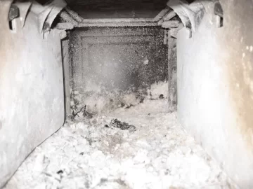

Here's a couple more shots showing the condition of the stove:
The interior heat shields are crack free, though the one on the left may be warped a bit.

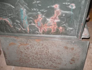

This is the bad side of the stove, with the stove top resting against the legs. The rusty spots on the side are generally where the cracks are. It looks like somebody tried to paint over the rust at some point. The top is crack free and the gasket is present.
That side looks awful in a flash photo :-)
That side is shot. Not worth repairing. Maybe try to locate another 118 and use this one for parts.
