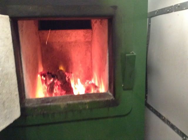

If it was black, it was creosote.

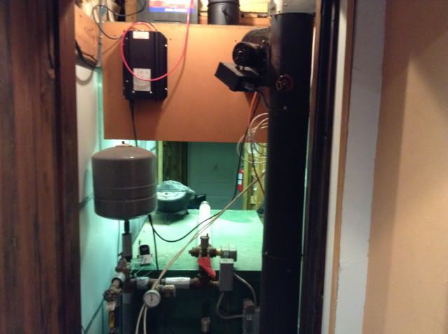

Also, might be pic perspective, but the flue pipe looks pretty close to some combustible stuff in places.
I will measure length of flue Tommorrow, Flue pipe is strapped to brick chimney on right, metal on door trim....Just noticed you are in Nova Scotia.....wife and I hope to live in Cape Breton one day soon.....I am always looking at Tradewinds Realty.....what a beautiful place....thanks PS, I will check out EBay....

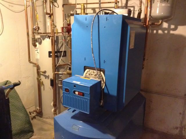

Why are you adjusting your Tekmar controller. A heat loss should be done and your radiation compaired to come up with an outdoor reset ratio. You can take a guess and then adjust it from there but that is done in days. Ideally constant circulation or near constant circulation is the goal with outdoor reset control.
I'm a licensed HVAC control guy.
